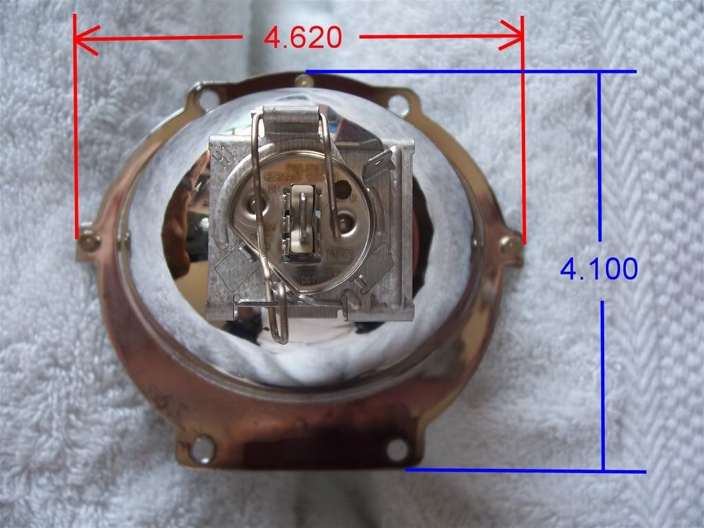

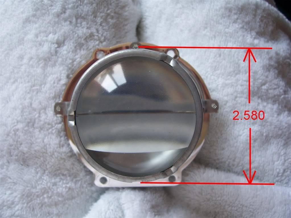

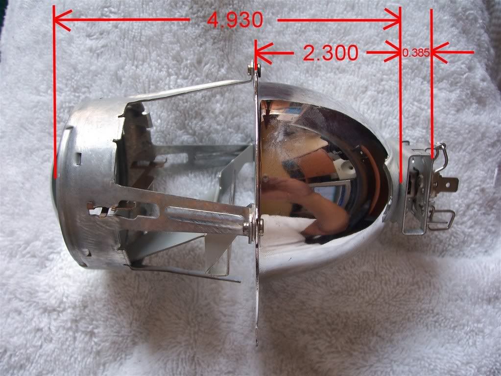

I wasn't sure if anyone would know this but off hand does anyone know the size of the stock projector? I'm considering putting those in my lower fogs and putting my 35w h1 6000k kit down there and a 55w 6000k kit in the lower beams with a TSX projector or the likes.

No it wont fit the projector is too wide. Your best bet is to get Bosch H3 projectors like the ones in the integrated fog lights and make an enclosure for them and use those.
