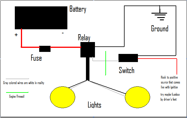

wire with the fuse to the positive battery terminal. sorry, it looks red on my work screen and this screen[/b]
yea it is red, when i said the orange wire i meant the wire you told me to tap into in the kick panel fuse box...
well, i think i got it all now. thanks a lot dude. early next week sometime on my next day off im gonna wire it up. i just painted them silver to match the car. should look hot, ill post pics when its done

Not sure if this diagram will help. This is how I wired my fogs.

Also, the Green/Black wire at the door kick panel is only hot when the ignition is on.
http://forum.mazda6club.com/index.php?show...c=66518&hl=
-Nik[/b]
thanks nik. yea i know how the grill comes out i replaced that already. ive had the bumper off quite a few times for different things. the wire advice helps tho. good lookin out my man
