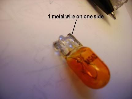

I just checked my fuse box under the hood and guess what? I found a blown out fuse! AFter looking at the LED and stock bulb, I found out that there is only one metal wire on each side but on the LED two wires are on both of the sides. Could this be the problem?
I provided some pictures to show you how the LED and stock bulb looks like.
LED
Came with clear side markers (identical to stock bulbs)

They are polarized= 2 wires.Plug them in one way,if it doesn't light up,turn off the lights and remove the bulb,turn it over to the other side,plug it back in and turn on lights.If that doesn't work,look for other problems.
Not trying to sound like a dick,but they say on the website on purchasing led's that they are polarized.
