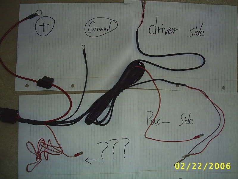

Need help now guys.. we've installed the rings and everything, but i dont know how to wire the harness that comes included with the DDE.... now, there are 2 red/white wires that i dont know which ones to tap to the parking light... and how about the other one? should i tap them into parking light for each side using the red/white wires? thanks...

Post a picture of the harness so that people can see what you are talking about

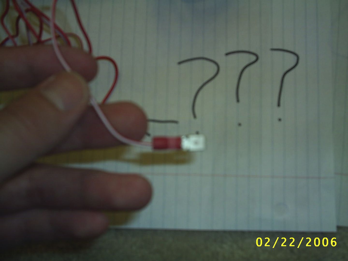

k here are the pics.....(sorry...its my first time posting pic )
this is the wire which we duno where it goes...

Looks like the wire that taps into the parking light...dont know why there would be two when there is only one relay...have u tried hooking up the question mark wire to the parking light and seeing what happens.

we tried using only 12+ for both of the red/white wires... and only 1 ballast lights up.... but when i change the driver to passenger, the other ballast lights up.... i tried to use 1, then both of them, still the same ballast lights up...

If the same ballast is always lighting up sounds like your other ballast is bad.

we tried switching from the driver side's to passenger's side, and the presumably bad ballast, lights up, and the other one doesnt.
