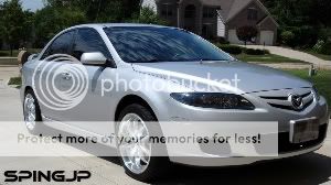

post pic of ur new rims..

QUOTE (Spingjp Mazda 6 @ Jul 10 2009, 01:23 PM)
post pic of ur new rims..[/b]
