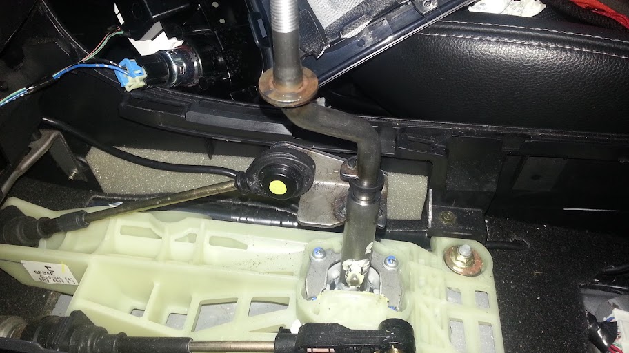

Glancing through the instructions supplied by CorkSport, I noted that MS6s with a build date of 10/05 and older require a 5/16" hole to be drilled to fasten the SSP to the OEM shifter. MS6s younger than 10/05 already have a threaded hole in the desired location. Knowing that my MS6 was built in 03/06, I figured I was looking at a 10 minute job. I removed the necessary trim and was greeted by this:
So CorkSport's got some bad build date information.
I disconnected the shift linkage and then drilled a 5/16" hole on the lower plane of the OEM shift plate using the hole in the SSP for a reference point. Once I ensured that the SSP was banked against the side and that it was as far aft as possible (while avoiding the welds on the OEM plate), I tightened her down and popped the shift linkage on.
Ignore the metal shavings. I cleaned up after I took the photo.

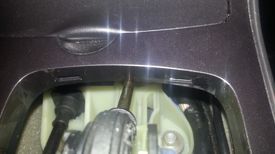

And then I put the console back together... The shift linkage rubs/grinds on the plastic lip of the shifter opening in every position except 2nd, 4th, and 6th gear. The interference is enough that you can easily see the console moving as you row through the gears. I can modify the console to eliminate the interference but I feel like I shouldn't have to with this type of product.
Here are some pictures of the point of contact in 3rd gear & neutral, as well as the clearance in 4th gear.
Overall, I like the feel of the product minus the interference. I haven't decided what I want to do yet. I was planning on buying JBR's kit before I unexpectedly acquired this unit so maybe I will buy one so I can compare the two. Either way, there is no way I can go back to a stock shifter.
