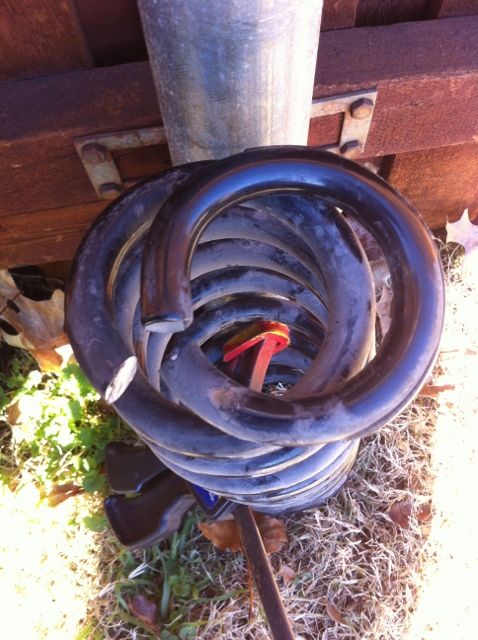

So, as many of you know, the options for MS6 springs is horrible now that RPM no longer produces springs. FORZDA 1 has run cut OEM springs for 30-40k on his car (which is also tracked), and has only raved about it. After much research and deliberating, I spoke with FORZDA and went for it.
  1. Cut 1 coil from bottom/skinny portion of the front springs
  2. Cut 1 coil from the top/larger circumference rear springs
  3. File the edges to make a smooth surface
  4. Use primer and black spray paint to seal the exposed steel
  5. Install

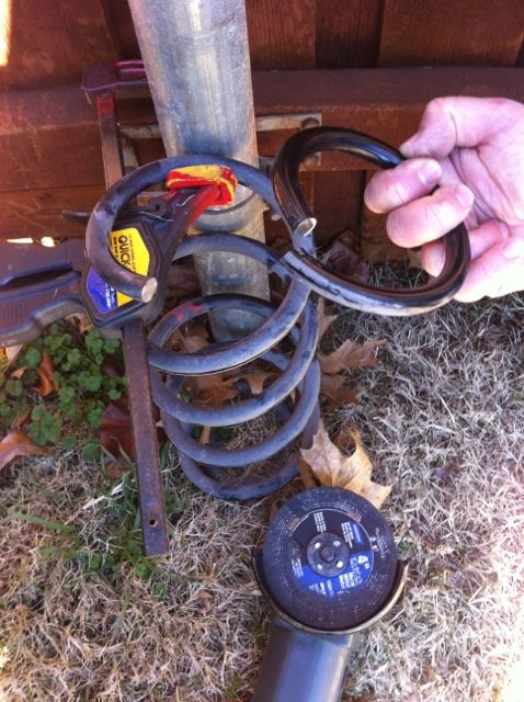

When cutting the coils:
  • Use only a high-speed machine blade, no heat or hack-saw (I used an angle grinder with a carbine blade-worked very well)
  • Move the blade in a back and forth motion while pushing down to give a single-swipe, smooth cut
  • Make sure to secure the springs well, I used a clamp, as seen in picture
  • Springs get hot, be careful
    When Installing:
    • Make sure the front springs are snugly seated against the bottom of the shock body. I loosened the spring compressor gradually, adjusted, loosened, ect.. to ensure it seated well
    • Make sure to loosen all the control arm bolts when putting the car back on the ground after installing, or it will not settle well on your various bushings. Once on the ground, tighten all bolts to spec. (see the how-to for #'s)
