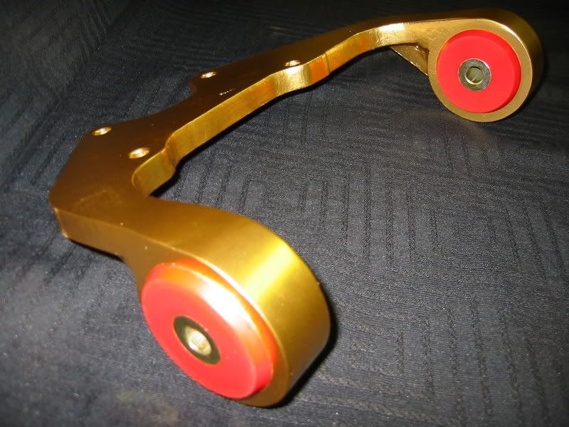

FORZDA 1
Aug 25 2008, 05:01 PM
QUOTE (FORZDA 1 @ Aug 22 2008, 02:47 PM)
That's a fact Jack. I will be breaking the edges (an engineering term for those so inclined who may be reading) and painting black before installation.
Here's a couple of photos after a bit of cleanup and paint. Not outstanding, but a bit better looking. It will be pretty much unviewable when installed and I really just want no rust...

Corpus_Speed6
Aug 25 2008, 07:09 PM
How thick is this thing supposed to be? Whoosh's mount is 3/8" thick.
whoosh
Aug 26 2008, 02:45 AM
QUOTE (Corpus_Speed6 @ Aug 25 2008, 11:09 PM)
not that it's a bad thing but the SU mount in the picture was certainly cut with a torch which is why there are no specs on it.
ususally when you can say "water jet" billet this or that you do but this is just a down and dirty slab of metal with bushings
again, not ness a bad thing.
my mount is 5/8" thick steel
not sure about the SU thickness although it looks comparable....

The SU mount is 16.3mm with the paint. Just a tick over the 5/8". It is pretty heavy at ~6 lbs. I think the choice would be based on asthetics and price as I don't see any way to design differently unless you went with exotic base materials... Structurally, a flat piece of steel is a piece of steel... Maybe use a thicker piece of tubing stock for the bushing mounts? The cut edges do show some stryations looking pretty much like cut with a heat source like a torch. Machine cut none-the-less. I'll be installing mine one day soon... when I get the time...

My bad, I thought I saw that yours was 3/8" thick.

So, does anybody who's received the SU brace have the TT bushings sitting around to compare sizes to? I'm curious if the final product might be able to house the TT bushings.

I have the extra bushings, but have not received a tracking number for my StiffDiff yet. Figures since a guy local to me ordered after me and got his tracking number. If no one beats me to it, I'll post bushing sizes between the two. I'm guessing they are the same, but you never know.

Sep 3 2008, 06:37 PM
QUOTE (ATE BALLER @ Aug 26 2008, 01:09 PM)
The bushings are not interchangeable. SU uses a smaller diameter piece of pipe for the round sections so the bushings have a smaller diameter as you can see in the pics. Interesting is the fact that the width of the internal part of the TT bushings is the same as the SU piping. That means that not only are the SU bushings not solid as seen in the pic, they are not wide enough so there will be a gap internal in the housing.
jmhinkle
Sep 3 2008, 06:47 PM
more pics of the thinwall piping and the bushing difference.

Interesting. That's the exact same problem AWR had with the trans mounts when those came out. They were undersized and walking out within weeks of installing them. They sent out redesigned bushings, inner sleeves, and spacers/washers for the void. That was a group buy catastrophy, saved by thegreatny's constant communication with Tony over there.

wow you would think su would have thought of that

The stiffdiff is not designed to use TT bushings. I will be very surprised if anyone can break our stiff diff, give it your best shot guys!

oh my....a 2 piece bushing?
did you mention the width of the bushing spacer is more narrow than the frame mounting point?
how much more narrow?

wow im not gona lie im really disappointed with SU after those picts. why is it so thin? wtf is with the multi-piece bushings?
whoosh, this is the part where u come out with your REAL rear diff mount that everyone wants to buy including me. thanks SU but ill be waiting for whoosh's

+1 I want to be putting some extreme torque through my diff next year. I don't want half a bushing walking out on me.

Thanks for the pic of Whoosh's. It certainly looks nicer than SU's, and, it looks like it uses the TT bushings. I've already installed my TT bushings in my stocker, so, I may have to get another set of TT bushings. But, that's okay. Whoosh's looks like da shit.

Two piece bushings like these, while imo they are garbage, don't generally walk anywhere because they should be held in place by another bracket on either side of them. The gap in the middle, while it is a bad design, isn't actually really used for anything since the torque load is going to be placed on the outer edge of the bushing.
The thin wall piping shouldn't be breakable imo, but with enough power and a soft crushable bushing you *might* be able to deform it. EDIT: Now that I think about it, the smaller diameter piping may eliminate any deformation.
I still think this is a solid mount that isn't going to go anywhere.
Having said that I think alot of us would rather build it one time and have it be able to withstand a nuclear holocaust intact.

Unless they get cut or torn they will still be good.

Basically, this makes sense and is probably correct. That the SU mount is probably more than good enough. Yet, if Whoosh's is even better, well, might as well get the best.

Explain this then (post 511 and on)...
http://forum.mazda6club.com/index.php?show...1220&st=500QUOTE (Corpus_Speed6 @ Sep 4 2008, 01:31 PM)
Having a smaller diameter also moves the location of the bolts down by half the difference. That might not be savy either.
Just my $0.02.

Yeah I saw that, I think its apples and oranges though. I don't think that the rear diff mount has the same rotating type force to contend with. The only problem I can see if that if the bushing is sufficiently soft, it could be crushed and deformed enough that the diff housing could come out of alignment and create some vibration problems that didn't exist before. I think that is really remote though considering that I don't think that the mount shift over more than 1/2" or so from its centerline.

I don't think that shifting the diff housing up by ~1/4" is going to effect anything. Worst case it might slightly stress the housing because the front mount will not be shifted up by the same amount, but since it is only 1/4" or so, that difference can probably be absorbed by the bushings or any slop inherent in the mounting system.

The bushing spacer isn't more narrow. It's the same width as the TT one. It fits perfectly into the holders up in the car. I don't think the bushings halves will walk out either. They are tight up in the two mounts. Guess we'll see with time. I installed all the mounts and the Whiteline swaybar today. Took 4 hours total to do it. Pulled a wicked 4 wheel burnout/drift out of my friends street onto the main road. Rear end feels nice and solid. No noise coming from it either. I did have to adjust my gastank a bit to the drivers side because it was right against the TT front mount when I first put it in and started tightening things up. I have to agree that, while I'm not overly impressed with the SU unit especially compared to Whoosh's, I don't think it will give you any service issues. I think you'll break something else before these mounts now.

Hey guys, NHRA Pro Stock race cars are built using .83 thou wall thickness tubing. Our stiff diffs are using .125 thou wall thickness. Our stiff diffs are rated for 800+ rwhp and comes with a unconditional lifetime warranty including the polyurethane. I highly doubt anyone of us are hitting those numbers... yet ;-)
Also the first few stiffdiffs on the market now are the final prototype design, not the production run. Production run units are shipping today, both units will do exactly what is needed, just look a little different. I am out of town until tuesday...

Yeah, I have no doubts about the strength or longevity of my SU mount. I indeed have one of the prototypes and it likely isn't as pretty as a production model, but I'm not complaining (>$). It isn't too often that I crawl under the car to check out the shine on the upper diff mount. I do wipe down the jewel-like 80mm CS polished exhaust though...
