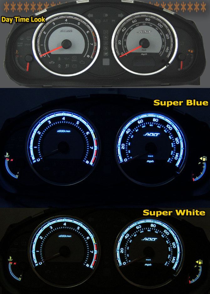

My ADD gauges.
http://www.cardomain.com/ride/399759...-mazda-mazda6/

Dude that looks sweet!
Are those just overlays?

Ya their just overlays from ebay. Cost me about 50 bucks and pretty simple to install. Here is the link- http://www.ebay.com/itm/ADD-Gauge-20...item484c3cac7c

Hmmmmmmmm I am not a super fan of the all red, but how are they on eyes if you do a lot of night driving? I turn down the brightness to almost off, and the bright.

Their very bright. I turn them down a bit. You can also switch between blue in the pic and a light bluish green (supposed to be super white but still have a bluish green tint to them) if you get sick of the blue. I love them. I'm not a fan of the all red either. The only red left in my car is the stereo which is gettin changed out when I can.

So how did you wire those up?

It was actually very simple. I didn't even pull the needles off to install. Just slid and worked the overlays around them and lined them up. It comes with a transformer and all you do is ground the transformer and hook the power wire up to the parking light wire on the back right of the gauge cluster. It is a darker green wire with a red stripe. Then just hook your overlays up to the transformer. Run your wires and clean up. The kit comes with instructions. This video is a light example. (I know its a honda but its just for example)
