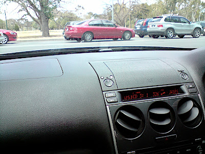

I installed the unit in my driveway, in the dark using nothing but the map-lights and a torch for illumination. I think that gives a clear indication of just how easy the install is.
I should point out due to time pressures (I needed to drive the car from Canberra to Adelaide the following day) I did not install the included Reverse camera or connect up the handbrake and reverse trigger lines. Instead I opted to leave these for later when I will also photograph the process.

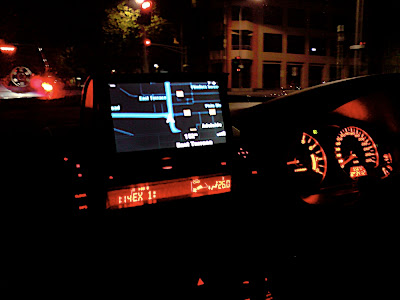

When the unit is active the other controls light up in a matching red tone to compliment the red theme used throughout the Mazda6. This is a great sign of attention to detail.
<div align='center'>
The clever motorised action of the cover and screen will keep children and geeks entertained and the "self-stowing" ability means that passengers will linger around in the car while the unit tucks itself away 10 seconds after the ignition is switched off.

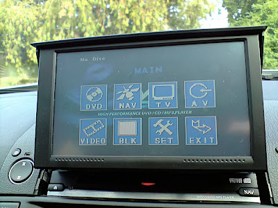

The units biggest failing would be the basic On-Screen interface, each power-on the unit defaults to the DVD function, a quick press of the "NAV" button on the lower right of the unit will activate the GPS function and take you to the default warning screen.
At any time you can switch between the DVD(MP3/MP4) playback and Navigation using these quick bottons.
This is preferable to using the crude touch interface that while being functional and easy to use will not impress your friends and is out of step with the smooth OEM style of the rest of the unit.

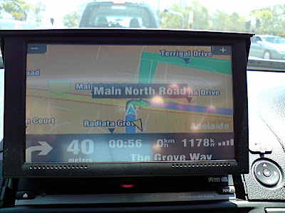

The GPS function uses Sygic (www.sygic.com) DRIVE and runs from an SD-Card - it's Windows CE based so the enthusiastic user could work out how to run their preferred software.
I found the mapping to be as good as my other Sensis mapped GPS, and the Sygic software to be functional and capable. It's not always going to take you the "best" route, like any GPS it doesn't understand local traffic and roads like you might, but it will get you there.
My test was quite simple. The morning after installation I powered up the GPS, tapped the screen and selected "Navigate to...", I entered my destination address (1 South Terrace, Adelaide, South Australia) and in less than a minute the unit had plotted the ~1200km journey from my East Canberra location.
Following the route through the city and open road proved the software was up to the task with clear directions issued on-screen and verbally. The unit appears to get good accuracy from the included antenna, although it may be a little less tolerant to "shadowing" than some other units out there, either that or those other units "buffer" their lack of signal to maintain the image of solid tracking.

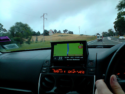

After 11 hours of cross-country driving I was approaching the city of Adelaide and once again the timely directions, on-screen lane indicators, current speed and speed limit information as well as street name information are all very easy to read and understand on a 7" screen. The route chosen through Adelaide was clear and simple, I'm not unfamiliar with the city but appreciated the "stay on main roads, keep it simple" routing that got me to the hotel with no fuss through evening peak-hour traffic.
